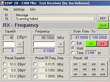

Scanning a particular frequency range is made very simple, including
an automatic
scan stop (3 methods) when signals are measured above a certain squelsh threshhold.
This function is not available on the ESVP itself, but is a great capability when
using the ESVP remote control software for radio monitoring.

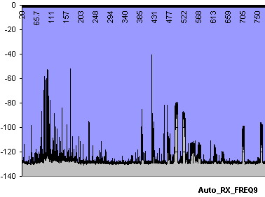

Also the measurement data can be easily transfered into excel. Several Excel chart
types can be preselected for grafical data presentation.

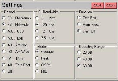

- Operating the main receiver settings, such as
* RF Frequency, IF Bandwidth and demodulation
mode
* Level Modes (AV, PEAK, CISPR and MIL)
* Squelsh, Attenuation level, Operating range and Function
mode
