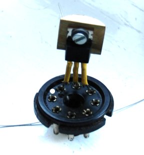

Here we have the valve base with
the white dot for identification between pins 1 and 8 and the long wires
on the IRF 510 have been placed in the pins 8, 7 and 6 which is correct just
as a try out as you will need to fix the IRF510 with insulating between the
tab and the heat sink secured by a counter sink bolt ( which in the picture
is the wrong way round the bolt head needs to be on the outside).
The other transistor BFY 51 can be fully fitted, and soldered in, before closing the case ensuring that no part of its case touches the case of the valve. NOTE: None of the pins of the base must be shorted to the metal case.
