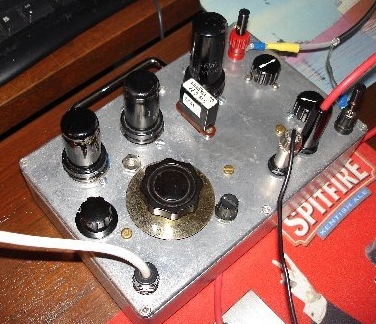

Operating with a copy of a
Paraset
I told W3TS, Dana 'Mike' Michael, of these
events during a QRP QSO on 20m and he suggested that I try my Spyset which
is a rough copy of a Paraset but with QSK, a TR switch and a volume control.
The output stage was changed to a true pi tank and the antenna tuning is
achieved via an SGC230 auto tuner. I used also a home made audio filter from
time to time during the 80m QSO.

What is fascinating is being able to copy
a US station on 80m on a home-made two valve receiver, regenerative detector
and one stage of audio, with a single valve transmitter that I built myself
from what are basically scrap parts. A single 6V6 easily gives 5 watts and
is capable of world wide propagation under the right conditions,
